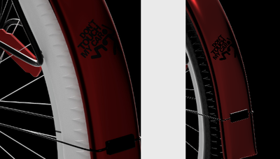

Hi ,
I don't know if my post in the right section .. but ,
there is a material bug on cloud render .. when you render it will show as white
but if you render it in local will be fine
I try the same material on some models , but same result
this material is " Leather -Matte (Black)"

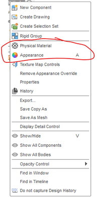

aliobidi
Message 4 of 16
TrippyLighting
@Steven_Gao There are several such material that differ between the cloud and canvas/local render.
Message 5 of 16
laughingcreek
@Steven_Gao - it's an appearance.  not in the materials.

so let's be more specific .. there is (appearance and physical ) and both are materials
Message 12 of 16
laughingcreek
nope!
the physical material is used for the physics properties, lake mass.
appearance is only the way it looks and has no bearing on things like mass.
you can apply both to the same object, but the material will be used for mass
and the black leather you pointed out is only found under appearances, not material, which is why @Steven_Gao couldn't find it initially.

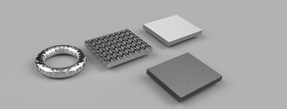

I've been digging into this a little deeper.
The material in question was originally "Steel - Brushed Radial Overlap". I changed the color to a much lighter grey so it would look more like machined Aluminum. Then I called it "Aluminum - Brushed radial Overlap" and saved it to "My Appearances"
Interestingly enough, in My Appearances it shows up in the Metal->Steel" folder.
So in the image below the torus and upper left box are Aluminum - Brushed Radial.
The upper right box has the Aluminum - Brushed Radial Overlap from My Materials applied to it.
The lower right box has the Steel - Brushed Radial Overlap applied to it.
In essence it's the Steel material that poses the problem, not the ALuminum.
Model is attached.
