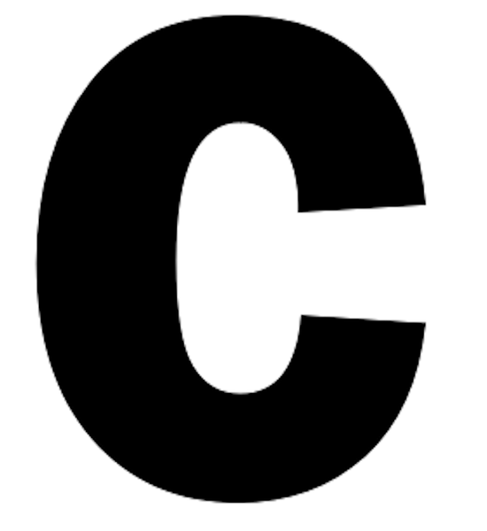

I am trying to create some large (200 mm tall) mountable letters based on a particular font. 1 letter per component.
When I create the text letter and set the height to 200 mm, the outline is fuzzy and pixellated.
If I extrude the letter, the profile is ragged.  Is there any way to get a cleaner result?
The images here are the desired outline (black), the Text (blue) and the extruded result (gray).

jhackney1972
The video will explain the process.  Be sure to open the attached model to see the final difference between the extruded text on the right and the modified text on the left.
If this answers your question, please select the  "Accept Solution" on my post.  If further help is needed please ask.

w0nrp
Hi, John.  That does make a much cleaner model.  Thank you for your effort.
However, if I make the perimeter box 200 mm high, and specify the text as 200 mm high, the result of the process is 206mm high and extends below the X axis.  At that point I can no longer resize it nor move it up to align with the axis.  I can enter a smaller value in the text height control, but I have to guess at the location of the bottom edge.
I need to make some features that require fairly precise locations on the model, so this is a consideration.
Do you have any further suggestions to accommodate this?

etfrench
If you need a precise 200mm height for all of the letters, you'll need to determine the scale size for each type.  For example: C may be larger than W. Serifs may make Q and some lowercase letters taller.
In this image, the text on the right was created at 200mm high.  The 'C' on the left was created with a height of 193.4036774742253 ( Height of 'A' divided by height of 'C' times height of 'A').
