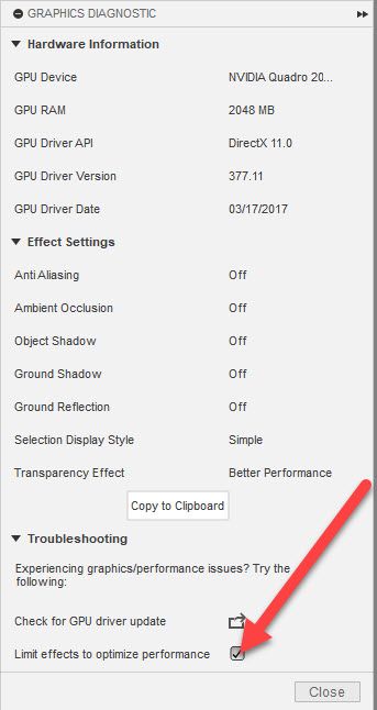

jhackney1972
You could improve your Fusion performance and turn off Ground Shadows at the same time by checking the box indicated below.  The second graphic shows where you can find the first screen in case you did not know.
