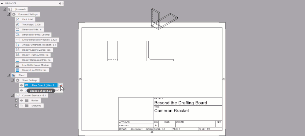

The ability to change from Landscape to Portrait is still there but only for A-Size in ANSi and A4-Size in ISO drawing templates.  ANSI template is demo below.

Go the Sheet Settings in the Browser and edit the Sheet Size, there you will find the A4 Landscape. This is a repeat of Message 4.

It is an easy process to change the orientation of the drawing sheet or to change the sheet size entirely after the drawing views are set.  The Screencast will show you how.
