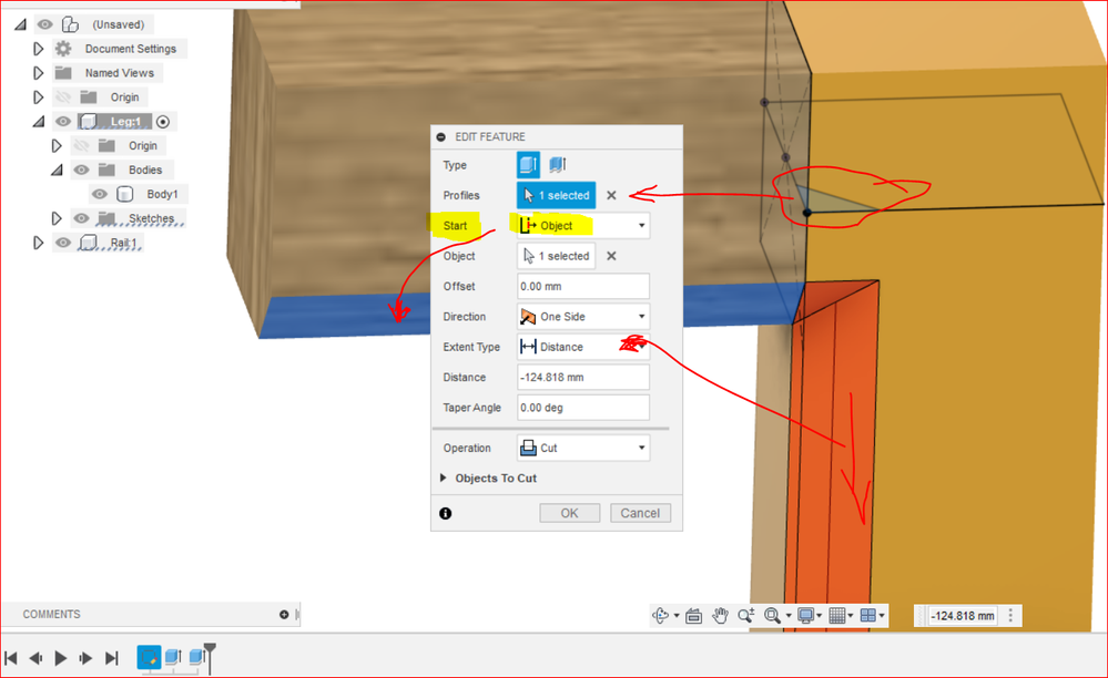

I will give an example.
i have 2 diffrent components like a leg that are connected to a border on a table, the chamfer must stop where they are connected and continue along the boarder seamlessly.
i have done this before joining components together but it messes upp the cadfile and creates problems.
maybe i just havent got the correct workflow for it?
Best Regards
Christoffer
Message 6 of 13
davebYYPCU
Like this?  Edit the 3rd extrude for the settings.
Might help.....

Message 10 of 13
davebYYPCU
There are a few ways to do this sort of thing, probably not the way I would do it, but as you stated you had the 2 components in existence, I just followed your lead.
I made the components, extruded their sketches, rail has inbuilt chamfer in the sketch.
For the yellow component, I added the triangle to the sketch,
Extrude cut, select from the chamfer face of the rail to start from, and take it all the way down.
Screencast and I don't get on.
Might help....
