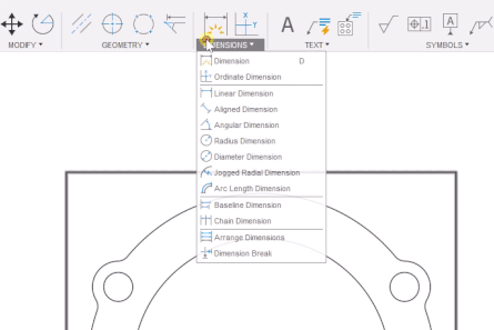

Just following up on this post. I hope you have seen the updates that we made to drawings:
We added More dimension units in Sept 2021, this allows for global alternate units.
Arc Length dimensions were added to the latest major release of Fusion:
