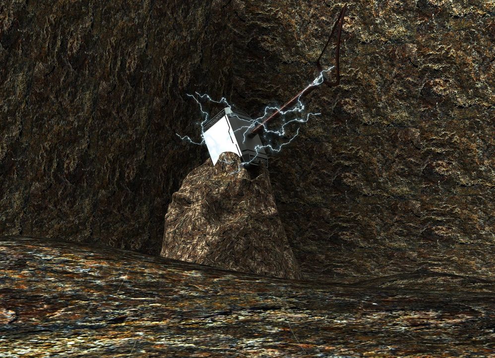

I was working yesterday on this model in the picture below, and I was inserting a mesh of the rock holding the hammer ( Mjolnir ) from Autodesk ReMake, and I tried to scale it and then align it but it didn't work, so I tried to move it instead, but another problem occurred, everytime I try to move the mesh it goes back to it's original shape again
I solved that by turning the quad mesh into a T-Spline body then finishing the form to get a normal body to use align or whatever I want
And it's so important for you to know that when you render your model the mesh won't appear as if it was never inserted
