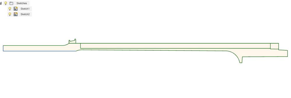

raycon2010
Taking a step back from the PNG import. I took a look at your main SVG file. It has a lot of info.
To simplify things. Consider splitting out the individual SVG objects from your main file.
The SVG format is XML based  you can pull out detail from large files real quick. Using search cut and paste from an XML editor  or a text editor and saving each node as its own file.   As an example I grabbed a few neck profiles at frets 1,6,12 from your main SVG file and created separate files. The image is a screen print from the main SVG file showing 3  "object nodes". (Whether or not the grabbed content is active or obsolete is TBD)
The individual files  can be inserted into their appropriate sketch planes  and moved to have a common origin or edited. If you go this route remember to fix/unfix  and maybe add a construction line at the geometric center to make repositioning easier. It took longer to write this post than it did to split out the content and insert into fusion.

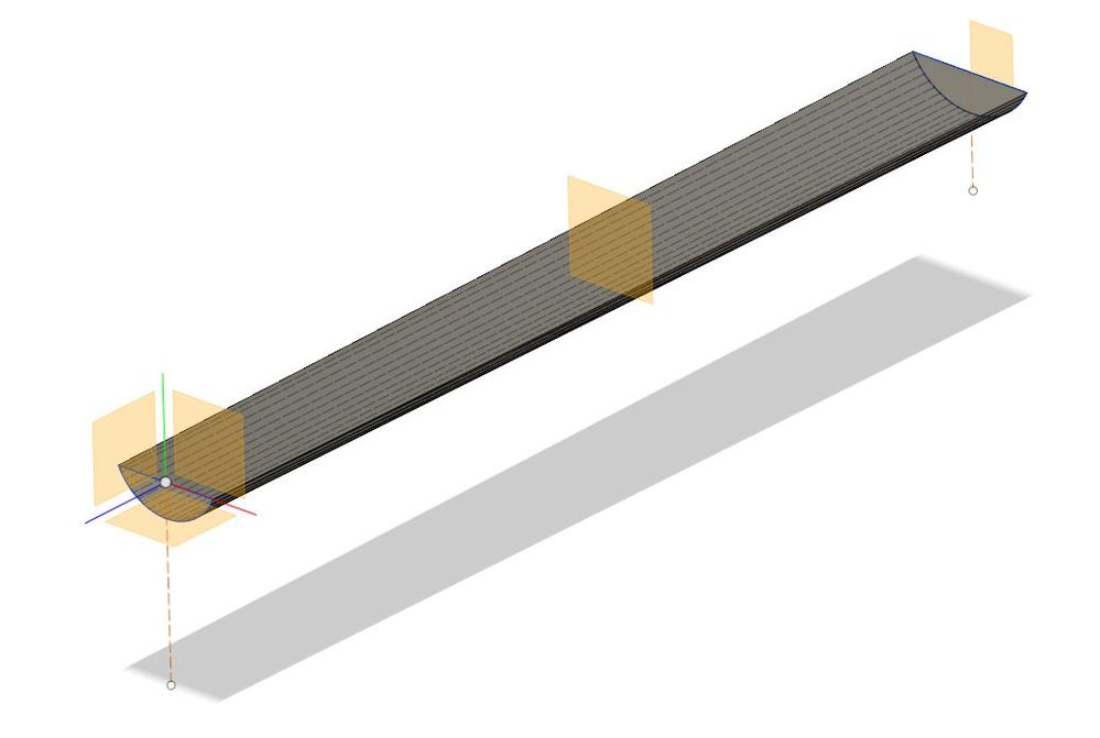

raycon2010
I attached a screen grab of a "loft" between frets 1 and 12 with a spacing of 12 . The below image is the 2 profiles used for the loft. The profiles were positioned at X0Y0 of each sketch plane using added construction lines (move command point to point) .
Inserted 2 profiles spaced 12" apartInserted 2 profiles spaced 12" apart

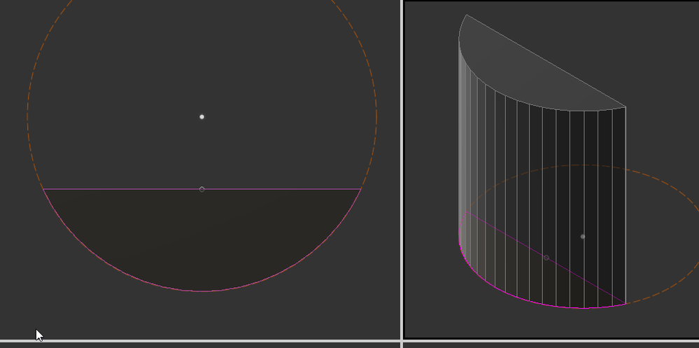

HughesTooling
I think you are going to come to regret trying to use SVGs for such simple parts. The SVGs are segmented and will become a problem when you try blending\filleting into other parts.
You can see here the shape is just part of a circle but the extrusion from the SVG is segmented into many straight line segments, is this what you actually want? If you want a smooth surface you'll be able to work with in Fusion you're wasting you time with these poor quality SVGs.
Mark

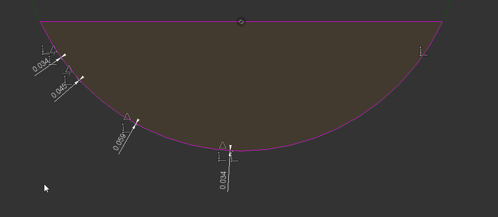

Message 9 of 13
g-andresen
Hi Mark,
I completely agree with you.
I think the values in this picture speak for themselves.
svg vs. 3 point arcsvg vs. 3 point arc
günther

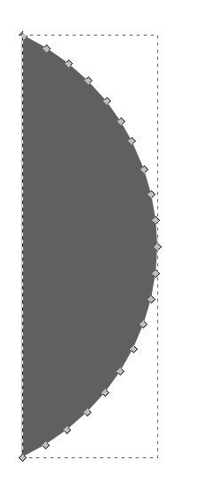

In this case. I'd ignore the imported profile  and look at the bigger picture the main  SVG file.  It's a 25,000 line file. The exported profiles are 30+/- lines each of SVG.   T
I'd probably try and work with the SVG file a bit.
Outside of Fusion
The below image shows the (Fret Profile  #1) polyline and  its path end points.  AI or  Inkscape may have  a  polyline to Path or Union or Combine path command - which will merge the points onto one path.  Creating cleaner geometry for an SVG import.  This would be done outside of Fusion. Ideally with a Select All command and  a mouse click.
End goal being to create a model for CAM from "this" SVG file.
 I'd  export the SVG sections/views from the main file I was interested in to separate SVG's.   Instead of tracing imported images. Overlaying a second sketch on top of the imported SVG. Using sketch 1  snap points to create sketch 2 geometry.   Deleting sketch 1 which has  the imported SVG profile when done. My end goal being a replica of what the SVG file contained "quickly".
Below image. Imported neck x-section and started tracing the shape onto a second sketch - blue lines.
neck.svg exported from main.svgneck.svg exported from main.svg

HughesTooling
@raycon2010 wrote:
Nice job on the overlay.
The engineer in me says keep the original detail don't approximate with an arc. Clean up the curve. If it were a cam we'd all agree .001's matter.
The trouble is the original is where all the inaccuracy is coming from. As a similar example make a cylinder in Fusion and export as an STL with course setting, reimport and make a section from the mesh, this is pretty much what's in this SVG.
Also the difference in a circle picked from 3 high points on the imported segments is a lot closer than the above example. See attached file. This shows the deviation at the midpoint of the lines at the corners it's far less.
There have been several posts over the years with imported guitars as SVG and DXF and in the end trying to fix the imported poor quality curve lead to a dead end as it always killed fillets and blends later in the design. More time was wasted trying to use the import than it took to trace using splines, arcs and lines and now we have control point splines it would be faster and easier.
