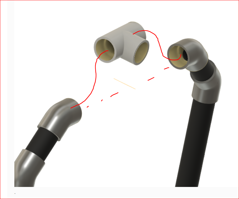

I'm creating a PVC frame, and I would like to create a couple pieces based on the design, so if I change dimensions of another part, it should automatically update.  Basically, I want to center a T-fitting between two 45 degree fittings, then connect the three with PVC pipe.
So I would like to do two things:
1) Center the tee between the fittings
2) Create two pipes between the tee and fittings, based on the centered tee.
Thanks!

Straight or bent pipe?
will need your file, to do better than ask you questions...
Straight.  I need to center the tee along the axis of the two 45's, maybe that's a better way to put it.  how do I post the file? Can I share it from fusion 360, or do I have to export?

I'm assuming you mean .f3z, I don't see an option for f3d.  It's attached. Thanks in advance for any help you can give, I appreciate it.

You already have the midplane, I dragged it to a size I can see.
Roll Timeline back between the Tee and the Plane,
Make sketch on that plane.  I got an origin point showed up in the sketch on centre of the outside pipe.
If that doesn't work for you, project a circle to the sketch from the 45 bend face.
Finish Sketch.
Make a Joint between the Centre point of the long tee barrel, and the origin / centre point in the sketch.
When the height of any of the frame changes, the Tee will follow.
Might help...
TIL about resizing construction planes... didn't know about that.  Thanks!  I got it from there.  I thought the midplane construction plane didn't get created because it was so small.
