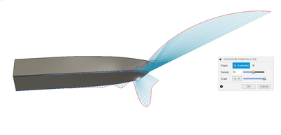

Im not sure why I cant shell this object. Any help will be appreciated and apologies for posting often, I just have to get this done and I have to learn this myself in short time notice.

with curvature combs that look like this-
it's not surprising that you are having difficulties.
your primary issue is the general approach your taking to modeling the hull.  it's a common mistake to think you can draw all the frames from a schematic and directly loft those.  but then you end up with input curves that look like this-
and things will only go down hill from there.
when lofting you want as few profiles as possible.  when drawing splines, you want as few points as possible.

Looking at the Insect->Curvature Map Analysis, that isn't a surprise.
You are using way too many loft profiles and as such over constraining the loft, which leads to surfaces wit uneven curvature.
