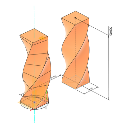

fundamental4
Hi @TheCADWhisperer
please see attached file.
Message 19 of 20
laughingcreek
would be simpler and achieve better surface quality to use a simple sweep without the coil. see attached.
Message 20 of 20
fundamental4
Definetely @laughingcreek , much much simpler.
thank you.
