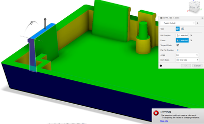

Hello everyone.  I am finalizing a design for kicking off injection mold tooling and I have a few faces that just refuse to draft, even though the rest work fine!  I cannot figure it out no matter how much I try.
Here are the surfaces that will not draft (including their error that do not offer much information to help).   I am attaching the file.

If you run a Modify->Compute All,
you'll find that there are 19 warnings in the timeline of this model.
If you click on the yellow warning triangle, it will show all the missing references that cause these warnings.
I would recommend to start this from scratch. Then model from the beginning with the proper draft angles applied and not trat it as an afterthought.
The timeline should only be 1/2 or 1/3 of what it is now.

well, the easy way to get rid of all the errors is to convert to Direct Modeling.  But, just be aware of what that means:  Your ability to edit the design is compromised.  If the design is nearly where you want it, and you won't need to go back and edit sketches, features, etc. then this can be an easy way to get there.
As for draft, draft is not magic.  There will be some geometries that just will not draft sometimes.  Here is one workaround for one of the faces that sometimes works. I cannot guarantee that it will work for others, especially non-planar faces...
The basic idea is to create a copy of the face, manually draft it, then use Replace Face to bring the modified face back into the solid.

The process I propose is the same as @jeff_strater suggested but with a method to keep the new body, created for the Draft operation, in place.  It makes the process much easier.  You will see in the video I had to play around with the Pull Direction Face but you will get it.  Basically select the face on the line between the new body and the existing body.  Your model is attached.

That absolutely does work!  Wonderful and thank you so very much for the detailed video.  I learned a lot from it.
