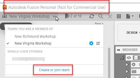

kirchash4
I'm on Fusion Personal (free). I don't think Team Storage is an option here.
jhackney1972
Yes, it is the storage method of choice.  You create your Team here.  After you create a Team you will want to use this website to migrate your files from Single User Storage to Teams.
