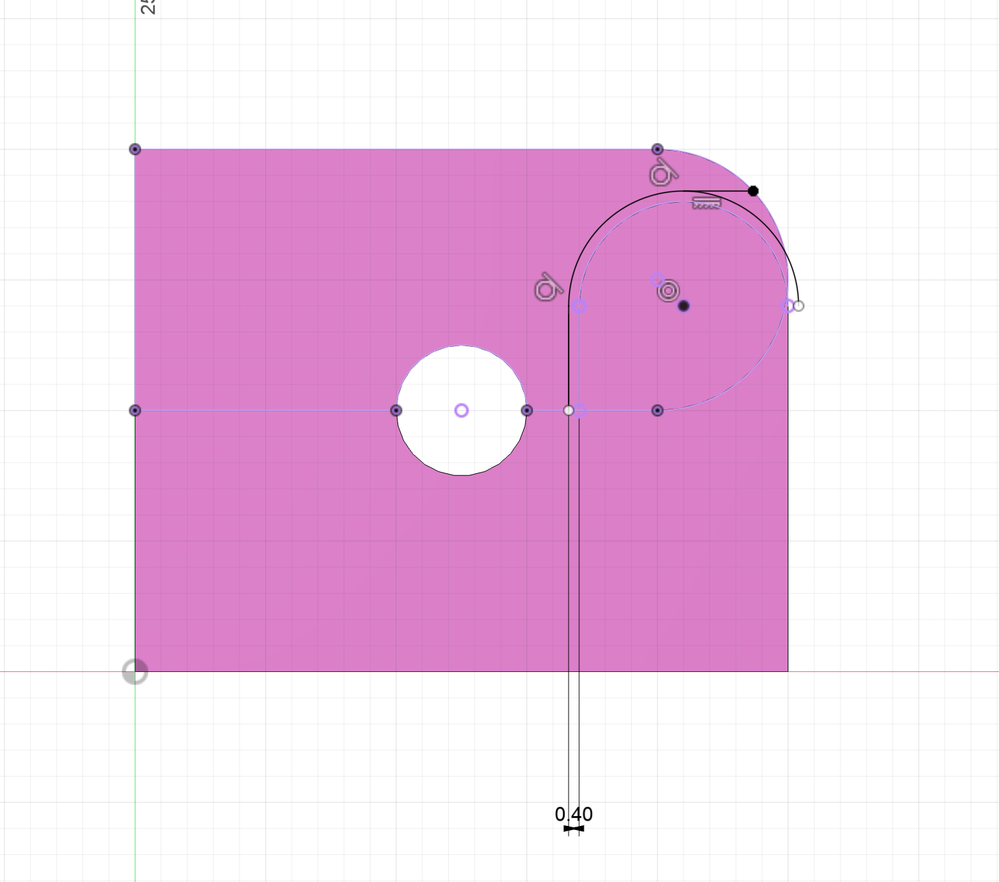

Hi All,
I'll preface this post by stating that I am very much a beginner with Fusion and CAD in general. I am attempting to build a parameterised design for a cable clip which is intended as a 3D print-in-place model.
I am experiencing an issue when I increase the Length parameter where Sketch 38 has an error, which causes the rest of the design to fail. Sketch 38 is on the Top body, using a projection from the Bottom body with an offset applied. The offset should be defined by a parameter, but it always seems to move to a fixed value (at whatever value the parameter was at the time I defined the offset).
I realise Sketch 38 is quite messy, and that's probably what's causing my issue, but I don't understand how I can go about fixing it.

Sketch 38
Sketch 38Sketch 38

johnjphillips82
With some more searching, I discovered how to right click on a sketch containing errors, and find out what the actual errors are - the revealed constraints etc throughout my design which didn't work properly, and I'll work through fixing them, which should resolve this problem.
