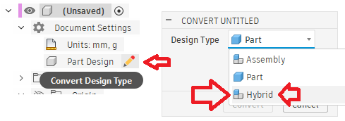

I have the same problem. There is no create component option anymore. And when I started the project I asked for Hybrid. Ho wdo I know its hybrid and where can I find teh option to change it?

g-andresen
take a look at Intent driven design
and several posts
günther

Your description has no relation to the topic of this thread, but rather to the recently introduced system of intent-driven design.
There are now various posts on this topic with instructions on how to select the “Hybrid” option in the preferences, for example, or how to switch between options inside active designs.
günther

TheCADWhisperer
@baron_von_richthofen_1974 wrote:
 How do I know its hybrid and where can I find the option to change it?
@zach_urrutia
