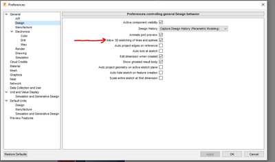

hi, sorry if this is annoying.  i read a few other posts on this topic, but i don't understand the answers.  i have all the necessary settings turned on in Preferences/Design, but it's still not working.  i'm trying to follow this tutorial:
https://www.youtube.com/watch?v=HmgwKewMcw8
around 37 minutes in, he's drawing arcs on surface planes.  he is snapping the start of each new arc to the end of the previous arc, on an inactive sketch plane.  i cannot do this, whether or not i have Snap checked in the Sketch Palette.  i get an X-shaped snap when i cross the edge of the surface, but i do not get the box-shaped snap when i cross the point that terminates the arc i'm trying to select.  i also don't understand how to use Look At, which other have suggested; it seems to fly to random vantage points.

laughingcreek
do yo have 3d sketching enabled in your preferences?
and in your sketch palette?
Message 7 of 9
titanium.rainbow
no, i don't.  i tried it both ways.  can't make it work either way.

hi again, sorry for the overly brief reply, and thanks for responding.
i should have said that i first tried doing the splines in 2D, but could not snap the new spline to the previous endpoint.  then i tried 3D, which allowed the snap, but the new spline seemed to hover about 1mm off of the new surface, i don't know why.  then i went back to 2D and tried again, after which i started asking for help.
checking the auto-project options doesn't seem to do anything.  when i used the Project command on the old spline, i still had a hard time snapping to the endpoint.  but for some reason, when i only Project-ed the endpoint of the spline, i was able to grab it.  i still don't know what Jason was doing in the video, but he didn't seem to be using Project at all.
