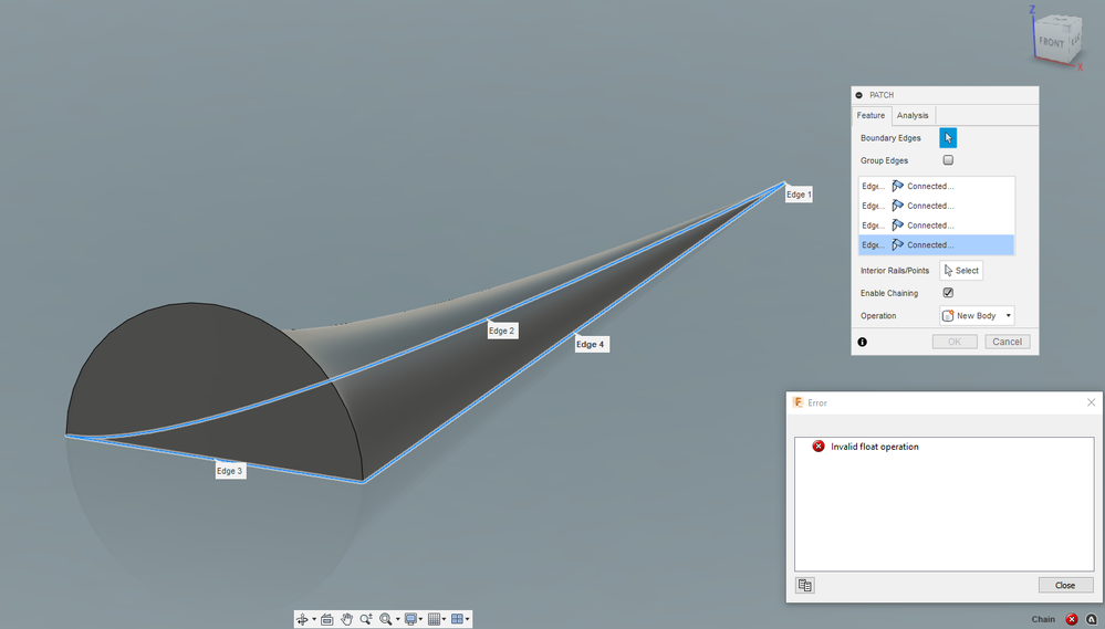

With these three inputs:
1. Half circle as profile
2. Straight surface edge as rail
3. Curved surface edge as guide rail
I can create a surface sweep 99.9% toward the end point. That last ~0.1mm is below what most 3D printers can print.
Then I create patches for the tiny front and the end and stitch them together (with 0.01mm stitch tolerance.
Unfortunately, when creating the bottom patch I am confronted with this error message, but I suspect If I do the sweep to 99% that will succeed.
Edit: Nope, not even at 90%. That means this pointy end isn't the problem, but the other "pointy" end is!
Edit 2: OK. A little bit more fiddling around and I got it to patch, stitch and now we have a solid body that is more representative of the shape than the lofted version.
