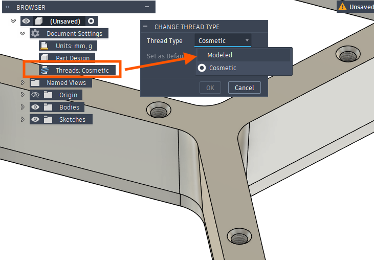

TheCADWhisperer
@office66YRG
Are you familiar with the setting for Modeled Threads?

office66YRG
Yes it was also my issue I mentioned few weeks ago, and this issue looks simillar.
Message 9 of 11
office66YRG
Yes, but these strange geometries appeared after I resumed the operation to check what was going on. I'm not sure why. I asked my colleague to redraw it to see if the issue still exists in the new project.
Message 10 of 11
office66YRG
This solution is unacceptable in our company. The reason is very simple: downstream users, such as CAM programmers or machine operators, cannot easily click on the correct position of the thread where they need to drill a hole. When threads are modeled this way, it becomes difficult to accurately select the hole position.
