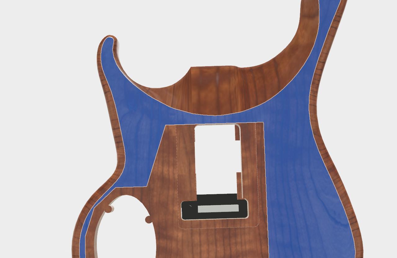

I've almost got this cavity relocation fixed but I'm having a weird issue (go figure.) You might remember I created my guitar bodies (front and back) through a combination of a solid body and a t-spline sculpt.  The finished bodies show as a single solid body. However, they still have the faces from the original bodies prior to the combine.  Look at the attached pic.  Is there anyway to combine the separate faces into one?  The problem I"m having is that I'm moving a sketch of the tremolo cutout on the back of the guitar to a new location.  One of the faces close to the neck doesn't show the new cut out.  I'm assuming it's since I did the original cutout before I combined that part of the sculpted body with the solid body that it's unaffected.
I think if I can combine those two faces the cut out will work correctly.  Can this be done?

Really hard to tell from just the pics.  One thing you can try is clicking dragging in the timeline to a new time position either the Combine feature or the cutout/body split feature in the timeline.  Sometimes you have to move multiple related features at once to do this, and sometimes you have to wait a little while when dragging to let Fusion calculate if such a temporal move is allowable.
