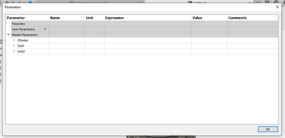

Hi, I am trying to create a copy of the original body that would be possible to change the parameters independently from original body.
Here I have two coils on the cylinder. One is original, another is a copy of it. For one of them I would like to change pitch, diameter, section size, etc. But whenever I change it, both bodies change.
How can I get just one of them modified?

The best way to have individual parameters after copying the body is to do that on a component level.
So create a component and copy and Past New the component into the browser.
Now you have new parameters for that specific component

Hi @dr.kaban. I tried to replicate your model, and I create the first coil in a new component. So I could Copy/Paste New. Then you will have a file structure like @Marco.Takx pointed out above.
Your Parameters list should then have this appearance:
See the attached F3D file.

Based on this image, I will suppose your F3D file remains the same.
You created a Coil, then created a component from this solid:
If you change this order, creating firstly New Component, which is always a nice practice, and then working in your first coil, you will get what you want.
Then you can Copy/Paste New this Coil component, and you will have two set of parameters.
I used this approach in the last file I attached here.

dr.kaban
thanks, it worked ))
