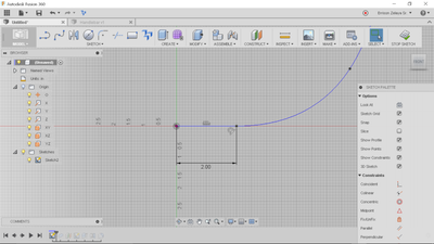

I'm trying to make a bike handlebar without a lot of progress.
I'm using the tube command...but I don't think this is wise.
The problem is the tubing is 7/8" OD with 1/8" thickness...except for where the stem grips it. How do I enlarge this section of about 2" (linearly). That diameter is 1.25"
Also, the bars have three sections:
the bottom bar (attached to stem)
the riser
the grip.
The bottom bar and riser are on the same plane, but the grip angles toward the rider 15d.
Any help?
Big Thanx!
-G

I was in the process of adding a picture then I couldn't edit the message.
Here's one side. Was going to mirror it after completed.

Try this,
At end circular section exactly where you were about to mirror , Add an offset plane at zero distance, then sketch two circles on that plane 7/8 and 1.25" then extrude the area between the circles in two directions to your required distance, with conditions set to join. That should do it

Zephyr958
Hi, GPriv.
The beauty of Fusion 360 is that it allows room for unlimited solution to your design.
Here is how I did it;
In order to extrude this coupling over the extruded pipe, the last 2-3 inch section in your sketch and therefore the pipe, near the mirror plane must be of a straight line not a spline.
On a an offset plane draw two concentric center diameter circles if you want the section to be hollow.
Instead of extruding as Join, I used new body, mirror, Finish by converting the bodies to components, and then assemble with as built joints, fillets etc..

My way of solving my problem was a combination of what I had and the Pipe command.  I added three circles in succession at the bottom tube and usedUntitled.jpg the Loft command to join everything. Then mirror. Then rigid joint.
Thank you again.
