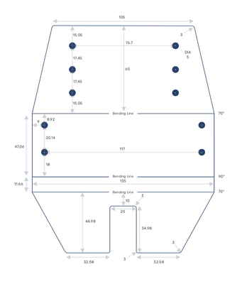

The problem with this approach is that I cannot give dimensions on the front view, which I am only able to see after I apply the Extrude command. I would like to, for example, make the top face edge narrower, as it is in the technical drawing below:

TheCADWhisperer
Trim surface and Thicken.
or
Flange
Unfold
Extrude
Refold
Back in a few minutes.
Edit: Is this a school assignment?  Do you have a technical drawing showing the dimensions of the part in folded form?
What is the thickness of the material?
Message 3 of 15
MRWakefield
I'd use the Sheet Metal workspace for this. You can create it in the flattened state as per your drawing then add the bends.

Wow wow! Exactly what I want to model.
I'm trying out to help the engineers of my work with some 3d modeling, although it's not my area (I am a graphic designer).
Thanks a lot for your time showing me this. I will study the file to see how you achieved it and try to do one myself. I might bother you again asking how you did something I couldn't replicate, I hope that's fine 🙂

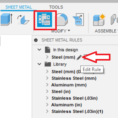

Quick question: how do you set the thickness after you add the Flange?
Thanks once again!
Message 7 of 15
TheCADWhisperer
Edit RuleEdit Rule
