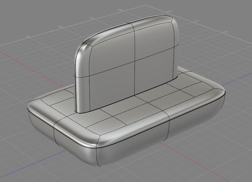

I am trying to merge two objects that have creased sections without deforming either, what is the best way of doing this in the sculpt mode?
To simplify the problem i've created two boxes in sculpt mode. As you can see, both objects have creased lines in the middle that are perpendicular to each other. After merging the two, the base object's shape is deformed near the creased lines of the vertical object. So what is the best way to merge these two?

Currently, looks like there's not a good approach to combine two TSpline body without any deforming. But I think you can do the merge after converting to a solid body. You can prepare the TSpline bodies in a form feature (in parametric modeling). Then use "Combine" command to merge the solid bodies. Just note that the input of "Combine" command must be solid body. So for your case, you can use "Fill Hole" command in Form environment to fill the holes (remember check the "Maintain Crease Edges" option). I attached a sample file for your reference, and feel free to let me know if you need a video to show you the workflow.

Not sure I fully understand what being asked. If the first image is two separate bodies, then after joining can you not create another creas at the base of the fin ?
In general, joining two bodies with uneven counts of edge loops and creases generates pretty bad topology for further editing.

I don't want the merged section to be creased and I don't want the edges of the base/bottom part to be deformed either.
Message 6 of 8
I want to remain in the sculpt mode, there's so much more sculpting to be done.

The T-Spline body is a network of faces and modifying one will have an effect on adjoining faces.  However there is a limit to the extent.  If you can place two faces between the area you want to modify and the area you want the shape maintained you can isolate local modification.  Faces can be added by inserting, subdividing or in the creation of the original primitive form.  Here is a video that I hope will explain.
