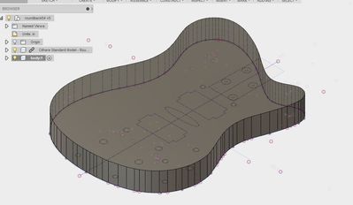

Thanks for the tip.  That seems to work better for getting the spline to actually show up, but when I create a component, new sketch, push-pull the outline it shows every point in the spline when I extrude.  Funny thing as well, if I trace over it with a native spline inside of Fusion 360 it also gives me the same thing.  It also seems to be very heavy graphically.  The program gets minimized for a while until it calculates the solid and then it comes back.  I find this hard to believe that this is the best workflow for creating a basic outline that is not straight lines??  Or is Fusion just not good with curves?  Thanks for any advice.
Here is a screenshot of the imported spline extruded, which looks identical to one that I draw inside Fusion using the outline as a guide for tracing on top with splines.

Pshupe
So even re-tracing the curves in Fusion results in this faceted solid?  I just used the spline command and traced over the outline.  I did place a lot of points, which is evident by the number of facets.  Would it be better with less points?  I'll have to test.  I've drawn this outline and imported different files about 20x now and I don't feel like I'm any closer to getting a nice solid at the end.  One thing good is that I only have to create this once and then use it for CAM toolpaths.  It's always frustrating to learn a new software and I really hope there is a better way to create a nice un-faceted curve so I can develop more of these models as I need.  Thanks for all the help.

HughesTooling
I think the problem you have is while tracing every click is creating a copy of the underlying curve. See screencast. One workaround might be to hold the Ctrl key down while tracing to disable snaps.

jeff_strater
@HughesTooling is correct if you are adding the spline in a new sketch (snapping to the curve in another sketch will auto-project the curve into the active sketch).  So, I would recommend editing the main sketch when doing the re-tracing.  Another consideration is that the faceted curves will also be recognized for the extrude.  I would recommend first converting all of those curves to construction before doing the tracing.  See the video below (which I made for a different thread, also on guitar design) for how I would approach this re-tracing problem:

Pshupe
Thanks Jeff, Mark, eellenburg and others.  This seems to work OK.  So adjusting the spline so it shows up and then tracing over an unselectable component seems to work OK.  Once I trace with small number of points I add points as required to shape the spline to the correct shape.  I will create the dwg pline file that only has the outline.  The rest of the lines can be in another file that I will use as a reference to sketch the other details.  Thanks again.  I wish I could just import the spline and push/pull, but this seems a reasonable work around.
