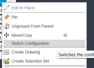

TrippyLighting
Select the linked component in the browser, right-click, and select Switch Configuration.
Message 16 of 18
hansvaneven
Thanks a bunch, but for this, the component needs to be linked ? I'm going to check this later
Message 17 of 18
TrippyLighting
What I suggested in my last post works with linked components only, for obvious reasons 😉
