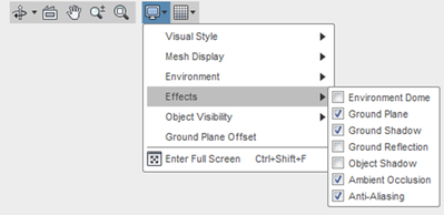

1. Is there a way to added for example a floor?
To create a floor, you'd have to model a floor in the Model workspace. Alternatively, you could also turn on the ground shadows option which may get you what you're looking for. Out of curiosity, do you have an example of the type of scene or sample animation you're looking to get out of Fusion?

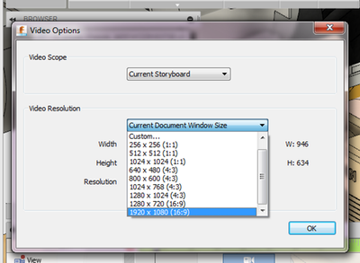

1. I also need to bring the final AVI in to PowerPoint. I Published a test in "full screen." It imported but the image is not as clear as I would like. Granted I am rendering locally, is there a render ("Publish") preset would you recomend that I try. Have you tried changing the resolution in the Publish dialog? 1920 x 1080 is currently the highest resolution that we're able to publish out right now, because we are using local compute to perform this operation. When we get the Animation workspace hooked up to RaaS (using cloud compute), we'll have much more control over resolution, but in all transparency that's still several months away.
