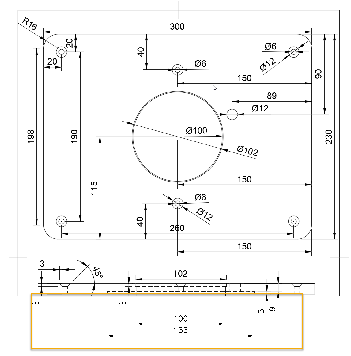

If you create a Drawing from a Design and have your Fusion 360 window maximized on a 4K monitor it will fail to render the bottom half of an A4 Page. This causes dimensions to be lost on the screen.  As soon as you reduce the screen to below the maximum resolution the dimension display.

I find just reducing the size of the fusion window fixes this 4K monitor/Windows/drawing issue. Try it at about 80% full screen.
