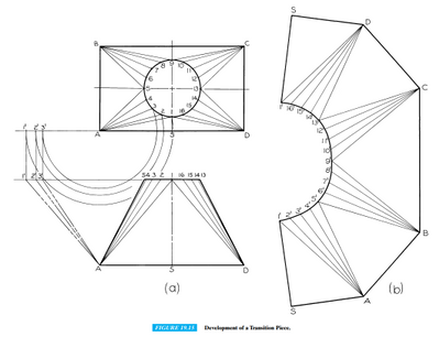

Not correct.
Arcs, not lines...
Giesecke et al Technical Drafting
Message 7 of 34

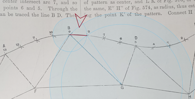

Here the sheet metal worker decided to use radial line development from the plan view (top)  some points are also projected from his elevation view  ( bottom) to populate his true length diagram (left).
then he uses the true length (left) diagram and triangulation to step out the flat pattern (right)
I also believe the method you provided is only from "regular" Form triangulation which if  applied to my current irregular form would start to break down and you would be left with a failed pattern.
Using radial line to populate the true length diagram only works for when all four four quadrates and the same or mirrored from the plan view.
here are a few pictures of a more common route for that layout.
I have another 20 layout books some over a 100 years in age that spell out how to triangulate a square to round to the same fashion.
My example is from
"the new sheet worker pattern book" 1926 Chapter VI Section 3 Irregular Forms (Triangulation)  Problem 179 PGS 331-333
I can provide more examples of standard old school pattern development  ?

Your book image shows arcs - not a polygon of lines.
I can't read the image to see how they developed the lengths, but I have several books myself and at least one of them is completely wrong.  The way we did stuff in 2D in the last century was a bit of simplification that was then resolved out on the shop floor.

yes that is a arc for sure...
The sheet metal worker uses a compass, dividers or trammel point to create the circle in the plan view.
after the circle is created they would step off or divide the circle into 12 points.
and later in the drawing during the actually pattern delovopment they would use their dividers to step off the 12(13) points of the patterns to "round" end.
Even through a compass, dividers or trammel points draw arcs to triangulate points. the points are used to construct the pattern.
The arcs are only used to find points.
Between two points is a line.
the pattern is made of lines between triangulated points.
Then a curve ruler, fridge magnet is used to approximant the curve through the points at the round end of the pattern.
