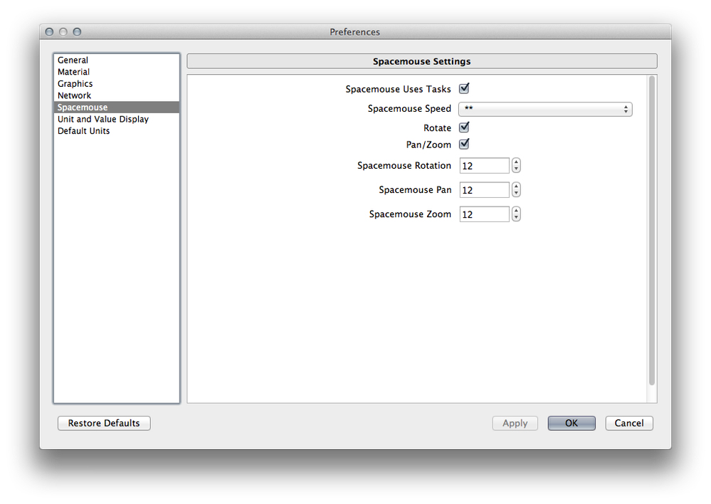

masureb
Good Trick.
I did not used the 3D Mouse because as others said: "It was laggy!"
But if you go on the preferences tab, Ifound this box and I uncheck it... Now it's much faster!
What does "tasks" means for the 3D connexion setting? From my side, I could advise to uncheck this and get good performance back when using your 3dconnexion but I could not explain why?!
Cheers,
Bertrand

Oceanconcepts
I tried this (unchecking the box) on a Mac system where the Space Navigator had worked pretty well, slowing when I had a tool active, particularly measure.
Well... it seemed quite zippy, even when I selected the measure tool- but it just kept spinning once a tool was selected, even with hands off the Space Navigator, and wouldn't respond to commands for a minute or so.  Switched it back and all seems well.  So it must do something important.

Message 17 of 48
Switching off "Spacmouse using tasks" solves this issue. Spacemouse is working now like a squirrel on caffeine... Smiley Very Happy
Message 18 of 48
YES! That's fixed it here. Mine's hyper as a caffeineated rodent also!
Message 19 of 48
garin
This is one of those things we implemented to work through differences between Windows and Mac. This option should be unchecked on Windows and checked on the Mac for the best user experience. In the future we will do this on the back end although we were using some of these setting for testing and validation. I suspect we will remove these shortly and have them set per OS and not something you will have to mess with.
