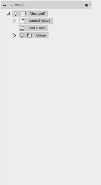

Message 4 of 13
O.Tan
Give us this is enough (CMD + SHIFT + 4)

3 screen shots in order  #1 show before highlighting with click and drag #2 shows highlighting of 4th and 5th axis as named in browser # 3 shows some parts un highlighted

I just tried to do the above problems in a new file  and both work , is it possible that something is set wrong in the file  that would cause both of these problems
Message 9 of 13
O.Tan
Hmm, not too sure. Can you expand all your browser tree and post a photo of it again? My guess is some of the component is grounded but I'm not too sure.
