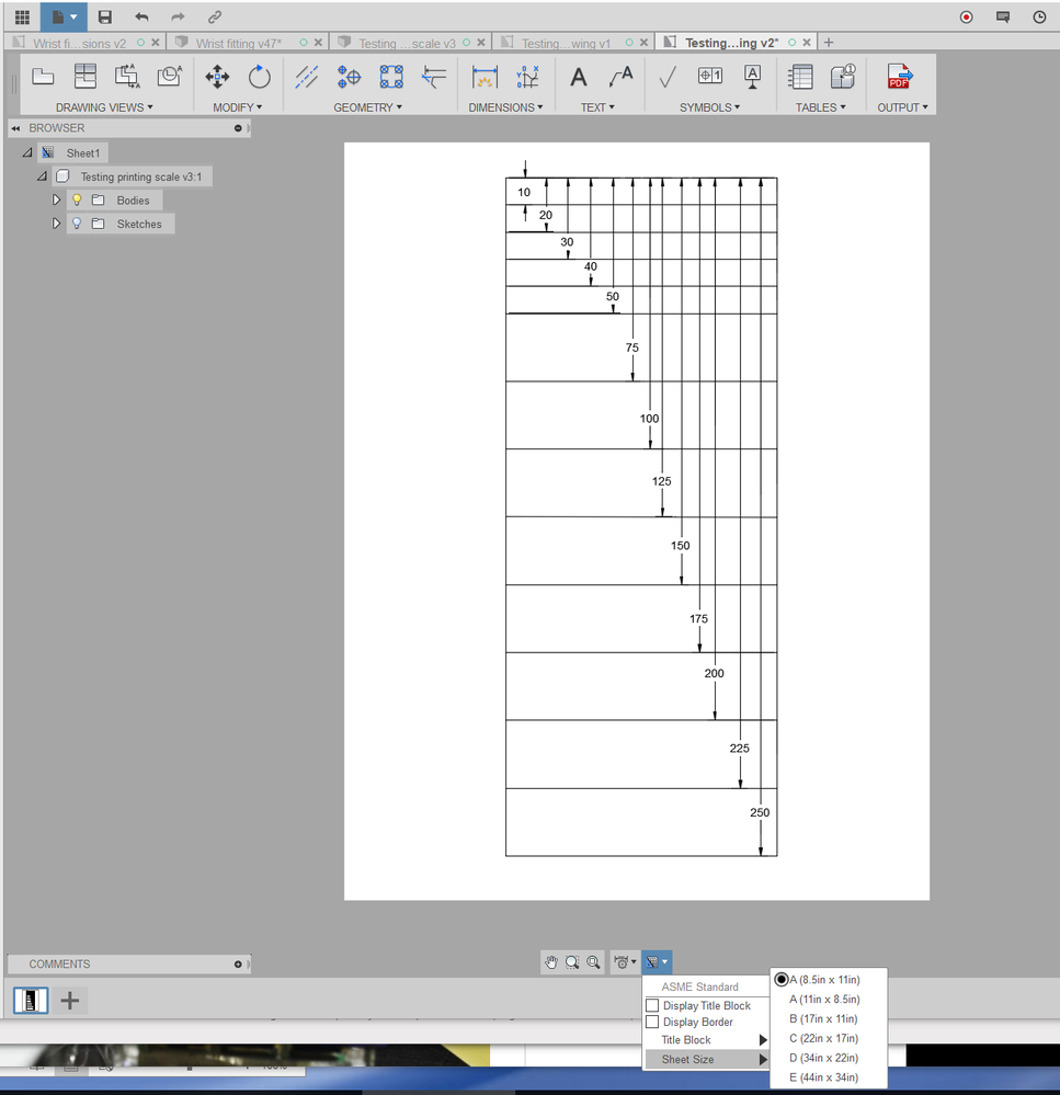

I noticed this problem a while ago, but now it's time to document it fully. Fusion does not print at 1:1 scale when it is set to 1:1; it prints at about 96.3%.
Here's an object that I made to demonstrate the difference. The object is a 250mmx100mm rectangle, with lines at 10mm increments and then 25mm increments. I extruded the segments to alternating heights of 1mm and 2mm (the extrusion is only used so that the drawing lines are clearer in the photo). Here is that drawing compared to an Incra metric ruler which has 0.25mm precision. The dimensions were added with the dimension tool in the drawing mode. 250mm, drawn to scale but not printed to scale250mm, drawn to scale but not printed to scale
The obvious response to this is to suggest that my printer is shrinking the image, or that the default outer border is having some effect. So, first I removed the border, but there is no change. I should also note that there are no printer options available in Fusion, at least not with my setup.

Thanks for reporting this issue.
I believe this issue could be because of an ANSI A size sheet (11'x8.5') [i.e. (279.4mmx216mm)] being printed on an ISO A4 (297mmx210mm) paper. For Fusion's ANSI A sheet, we always print the layout area between point {0.04',0.13'} to point {10.96',8.37'}, so that we have most of the border in the print. So the printable area for ANSI A sheet is 10.92'x8.24' (i.e. 277.4mmx209.3mm). We try to fit this area within the printable area of the paper.
For the printer I debugged, which has only ISO A4 papers, I found that ANSI A sheet is getting printed on a paper with a printable area of 273mmx209.55mm. To adjust the layout on this paper we have to scale the print.
We can do 1:1 if we ignore some part of the border while printing. Please suggest if it is OK to ignore some part of the border while printing.

cmiller66, I can confirm that it's designed as an ASME 8.5 x 11 letter. Aside from the fact that my setup doesn't do any ANSI letter <-> A4 conversion (shown with screenshots below), if you run the numbers, this is NOT just an error when converting between paper sizes, because 96.3% is not a conversion scale between A4 and letter. With both in metric, A4 width is 210mm while letter width is 215.9mm, which is 97.2%. Meanwhile A4 height is 297 while letter height is 279.4mm, which is 106.3% (or 94.1%).
I just checked my ruler against 150mm calipers and it is dead-on accurate to the extent that calipers can measure, which is roughly to 0.02mm over 100mm. My SmartDraw printing measures exactly 250mm at its 250 mark, and I checked its 100mm line with the calipers and I got 100.03mm. This metric ruler has hole spacing at 0.25mm, and each of those holes is 0.5mm in diameter (thus fitting 0.5mm mechanical pencils - pretty clever), so even the ruler measurements can be very precise.
Add all this together, and we find that my printer is making the lines more-or-less exactly where they are supposed to be, and my tools are measuring those lines to within 0.1mm over 100mm even after accounting for line widths. Every time, every line, it comes out between 96.0% and 96.5%. I've spent a disconcerting portion of my software development career counting pixels and fixing micrometer-sized errors and this is ringing alarm bells in my head, because this shouldn't be going through any paper size conversion. But mostly because this might be a very old error, or one that has occurred in the past. I happen to have a product from years ago that was inexplicably made at 96.4% scale; but the company could never justify why or explain how it happened. If the factory made measurements off the printed diagrams, then this could be the explanation - which is remarkable considering that the product is a piano. It's an unlikely chance, but it might solve that mystery.
cmiller66, here's a screenshot from Fusion showing that ASME A 8.5 x 11 is selected
Sizing sheet, showing ASME A 8.5 x 11 letter sizeSizing sheet, showing ASME A 8.5 x 11 letter size

So as far as I can tell, this is a Fusion error.
