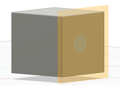

I have created a sketch point, construction plane and circular sketch that is parallel to the face of the cube as shown in the image below. I would like to then run a script which extrudes this sketch through the cube.

But I can see the extrude in the timeline and when I manually click, 'Edit Feature' then click `Ok` without changing anything it successfully creates the extrude cut.
