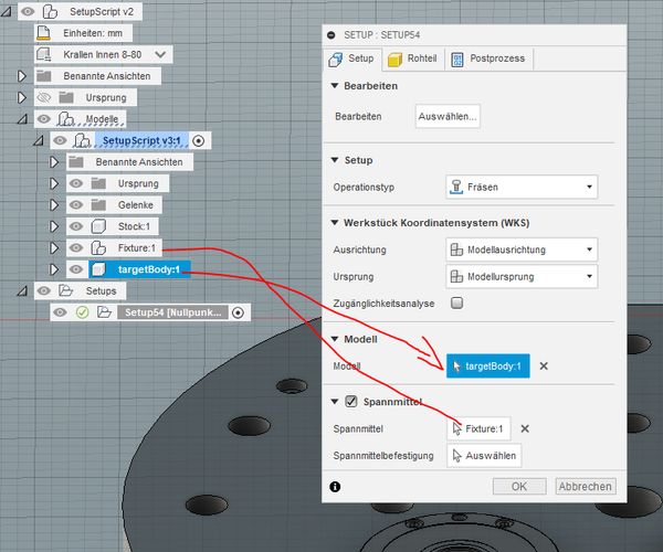

The result looks like this

@j_zander -San.
I may not be understanding what you mean.
Do you mean like this?

        # models
        modelsOcc: fusion.Occurrence = root.allOccurrences.itemByName("targetBody:1")
        if not modelsOcc: return
        # fixtures:
        fixturesOcc: fusion.Occurrence = root.allOccurrences.itemByName("Fixture:1")
        if not fixturesOcc: return
        setup: cam.Setup = create_setup(
            camObj,
            [modelsOcc],
            [fixturesOcc],
        ui.messageBox("Done")

j_zander
in reply to: kandennti
Perfect! That's exactly what i wanted! Thank you very much!
