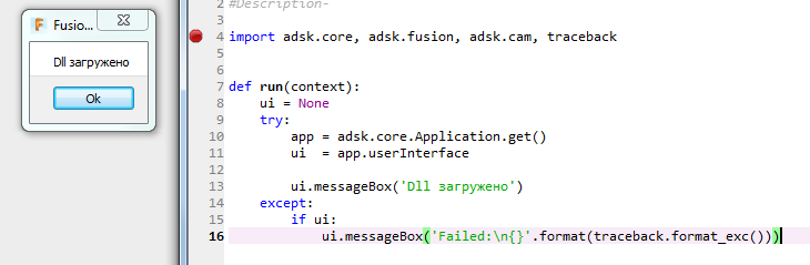

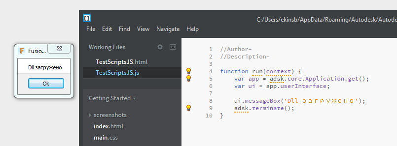

And how to use Russian letters not in C++, but in JavaScript and Python?
P.S.: I'd like to write article in Russian about using non-english letters in Fusion 360 API. So additional information will be very helpful.

In Python and JavaScript there's nothing special you need to do because they natively use Unicode strings.
