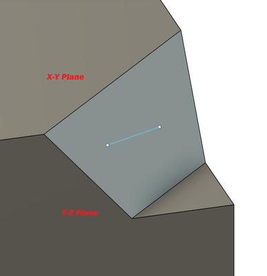

How do you draw a rectangle on a plane that is not parallel to one of the origin planes using API?
The center of the rectangle is at one of the end points of the line, and the long side of the rectangle is parallel to the line.

One way is to draw the rectangle on a sketch on YZplane or XZplane and then making a projection of its lines over a sketch over the tilted plane.
Does it make sense for you?

Is the line in a sketch that was created on the face you want the rectangle on?

I don't think that would work because the dimensions would not be correct.

I'd suggest two more options:
1) To draw the rectangle on a new XY-based sketch, and then apply a transformation (rotation and displacement) to it.
This transformation have same rotations as the sketch when you draw the line; and a displacement from rectangle center point to one of the line's end-points.
2) Keep a copy of the transformation matrix of the current sketch (where you have the line), calculate an inverse transformation of its matrix, which will translate the sketch to a XY-Based sketch; then you can draw the rectangle with dimensions; and finally apply the already kept transformation matrix to set it back where it was at the beginning.
Does any of this options make sense for you?

I'm not 100% what you need, but here is a script that prompts you to select a sketch point. It expects that point to be the end of a line. It then creates a rectangle in the sketch the line is in that is centered on the selected point and oriented parallel to the line. The size of the rectangle is hard-coded in the script.

@BrianEkins, the rectangle sketch plane is perpendicular to the plane that has the line sketch and parallel to the line.
The line would actually be where the two planes intersect.
I am creating a die spring.
The path for the spring and the guide path are created in the sketch with the line on the selected plane.
Hopefully the picture will help explain what I am trying to do.

Sorry, but it's still not clear to me what the geometry is. Maybe post a model with the results you're trying to create by manually creating it.

Attached is a step model of two springs.
The red spring is correct. The rectangle is perpendicular to the centerline of the spring, and parallel to the plane it is on.
The plane the red spring is on is parallel to the X-Z plane.
The blue spring is the problem.
The plane it is on is not parallel to any origin plane.
The rectangle is not perpendicular to the spring centerline or parallel to the plane the spring is on.

Sorry that it's taken me a while to get back to this. I'm still struggling to understand the geometry. It isn't easy to see the orientation of the geometry in a 2D picture. Maybe forget about the spring for now and focus on the initial input. You have a plane and a line. I don't know if the line lies on the plane or is perpendicular to the plane. From the STEP model I can now see what it means for a spring to be "on" a plane. I think what would help is to show the input the user provides to your program. And then go step-by-step through what you need to create to build the spring. Because the model is a STEP file I can't see the modeling operations or the sketches you created.
