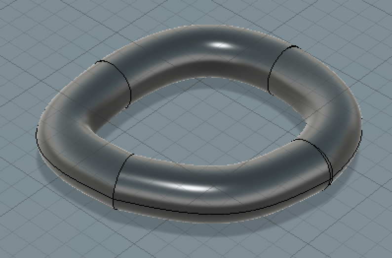

1st problem)
I have attached an example python script which illustrates the issue I'm having with sweeps.
Overall my goal is to create a closed-path sweep consisting of multiple merged splines, then dragging a profile over that single closed-path spline to create a pipe.
I also tried a method of creating a sweep for each spline, but ran into the same issue as I recall. I suspected merging all splines into one path might simplify sweep computations.
The attached script contains two "face" datasets and two methods of merging the splines. For one set of face and method, I am able to generate the desired model, but it takes forever to compute and as I said, doesn't work for the other dataset.
Overall my goal is a pipe like this,
using this 'one face' dataset of (4) splines,
'2nd face' dataset: (5) splines
showing single spline and profile, but this fails to compute given the following error.

Hi Sean,
The problem was that the profile you made was not perpendicular to the close path. To make the profile perpendicular to the close path, create a construction plane along the path, create the sketch on the construction plane, then create sketch circle on the sketch. I updated your script as below. It works.
#Author-seanharre@gmail.com

        do_pipe = 1
        if do_pipe == 1:
            splines = adsk.core.ObjectCollection.create()
            spline_prev = None
            first_spline = None
            for spline in all_spline:
                splines.add(spline)
                if not first_spline:
                    first_spline = spline
                if spline_prev:
                    spline_prev.endSketchPoint.merge(spline.startSketchPoint)
                    pass
                spline_prev = spline
            if not splines:
                all_spline.clear()
                return
            # CHANGING THIS COMMENT = WORKS
            #  -> CLOSED_PATH #1:
            #       does not work, F360 gives error
            spline_prev.endSketchPoint.merge(first_spline.startSketchPoint)
            #  -> CLOSED_PATH #2:
            #       works for some reason, but takes a long time and spins CPU fan
            #spline_prev.startSketchPoint.merge(first_spline.endSketchPoint)
            # Create a path for the sweep path and guide rail
            path = rootComp.features.createPath(splines)
            #guide = rootComp.features.createPath(line)
            # Create sketch for the profile to sweep
            planes = rootComp.constructionPlanes
            planeInput = planes.createInput()
            planeInput.setByDistanceOnPath(first_spline, adsk.core.ValueInput.createByReal(0))
            plane = planes.add(planeInput)
            sketches = rootComp.sketches
            sketch = sketches.add(plane)
            center = plane.geometry.origin
            center = sketch.modelToSketchSpace(center)
            sketch.sketchCurves.sketchCircles.addByCenterRadius(center, 0.1)
            prof = sketch.profiles[0]
            # Create a sweep input
            sweeps = rootComp.features.sweepFeatures
            sweepInput = sweeps.createInput(prof, path, adsk.fusion.FeatureOperations.NewBodyFeatureOperation)
            #sweepInput.guideRail = guide
            #sweepInput.profileScaling = adsk.fusion.SweepProfileScalingOptions.SweepProfileScaleOption
            # Create the sweep.
            sweep = sweeps.add(sweepInput)
