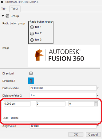

Is it possible to format UI components to place multiple inputs on a single row such as 2 or more dropdowns or value inputs such as this graphic?
If not, can this be accomplished via Pallettes?

Hi @JohnBuehler .
This is possible with TableCommandInput Object.
http://help.autodesk.com/view/fusion360/ENU/?guid=GUID-C3F746B3-6488-4B74-A441-31AFDEFD1648
You can find a sample here.
http://help.autodesk.com/view/fusion360/ENU/?guid=GUID-e5c4dbe8-ee48-11e4-9823-f8b156d7cd97
Due to the large volume of the sample, this is what it looks like if you only use the part that relates to TableCommandInput.

JohnBuehler
Kandennti,
Thank you for the detailed explanation, it is extremely helpful!
John
