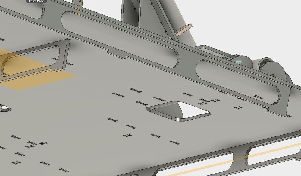

Hi.
I have had some hard days with drawing a welding fixture. All parts will be cutted with laser and welded together.
So, all holes needs to be dogbone holes to fit the opposite part.

Here it a part of one och the fixtures im doing.. just to get a visual on why I need a tool to make these dogbone hole and corners..fh.JPG
