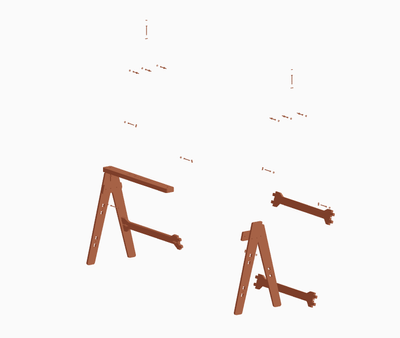

I have a similar problem as this one:
"Background: I'm working on a script that will let me export STLs for all the unique components in my Fusion 360 assembly along with a JSON file containing the position and rotation data info for all the occurrences (aka occurrence.transform.asArray()) .  I ultimately want to use this model data to recreate my project on the web using Three.js."
First problem was getting the right transformation form nested parts. Thanks to this post: https://forums.autodesk.com/t5/fusion-360-api-and-scripts/incorrect-transformation-from-occurrence-t... this is solved. But not quite.

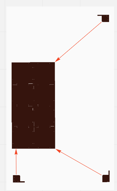

The resultant assembly is not showing the right location of the parts since these parts have a "Rigid Joint" and therefore, their location is not the same as the transformation matrix. (see picture below)
Top view: Left-> Fusion; Right-> ViewerTop view: Left-> Fusion; Right-> Viewer
The positioning of the parts directly relates to their respective origins, but I can't get the information remaining, which is the location of the rigid joint of each leg assembly to the top table so I can calculate the resultant final location.
legs offsetlegs offset
So I guess my question is if there is a way of getting the Occurrence/BRepBody position or transformation matrix based on the overall origin and not its own origin?

Hi there @BrianEkins,
I just implemented what you suggest and what I get is not quite the transform matrix relative to root. I'm passing the occurrences one by one to this method "getFullTransform", but the resultant matrix is not right.
(Image attached of the resultant full assembly.)
Please see 3D model attached.
