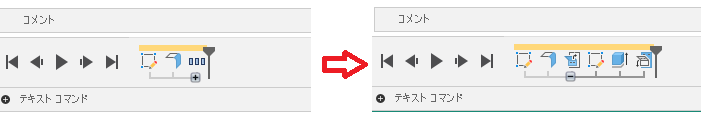

Is it possible to modify a FlatPattern object from the API, for example create a sketch on a face, extrude cut it out and then export to DXF?

Hi @PW_VOX .
I tried it.
When I run the following script with the attached data active, it modifies the image from left to right and exits.

If the Unfold group in the timeline is collapsed, it needs to be opened.
When collapsing the group again, I got an error in the rollTo method, so I moved the timeline marker to the top and collapsed it. The cause was not found.
PW_VOX
Thanks for ypur effort, I'll study your script and come to you
BrianEkins
I think this may be what you're looking for. It's using functionality that was new in the previous release to access or create the flat pattern and then creates a sketch and extrusion on the flat pattern model.

PW_VOX
Thanks Brian, that is exactly what I was looking for.
