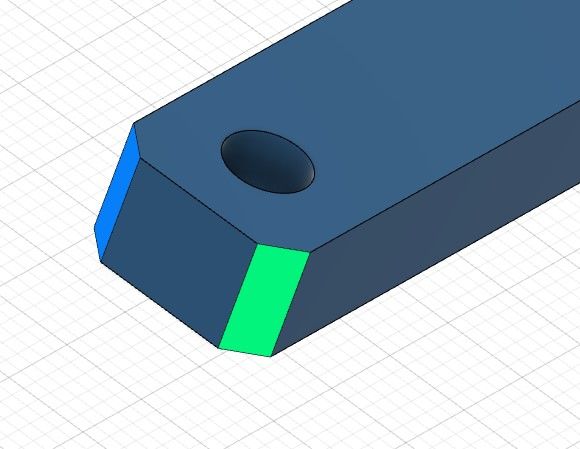

I am trying to create a function to find and remove features (mainly chamfer, fillet, hole) of a model. The model is imported from external CAD applications, therefore no information about features or design history/timeline is available.
The current problem is with the features-finding-stage: I tried to use the native 'Find Features' command but the result was inaccurate.
The wrong surfaces are identified as chamfers. The relevant model is attached for reference.
Is there any alternative to recognize the features in a model?

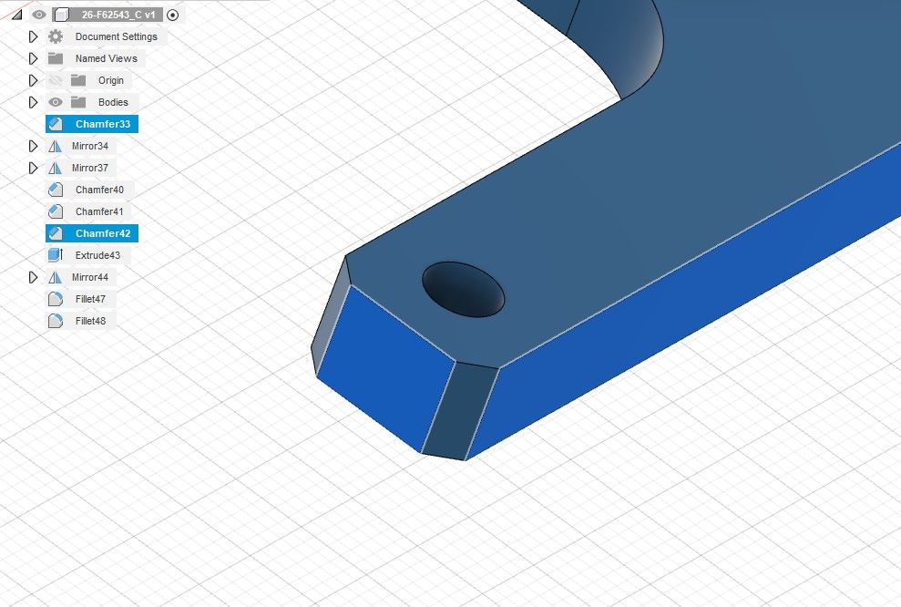

While I was looking for alternatives earlier, I actually tried the 'Remove features' function in the Simulation workspace (Simplify mode). Surprisingly, this function recognizes the chamfers correctly.
 Do you have any idea on the reason behind the different behavior of these functions? (Find Features & Remove features)
