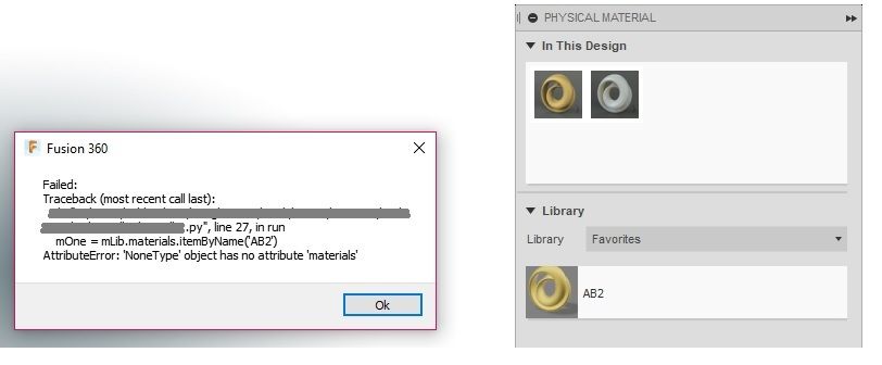

I trying to pick a material stored in my 'Favorites' and assign to a body but get the error shown in the pic.
I've used the following code, and worked fine when picking from the 'Fusion 360 Material Library'
# get material lib
mLibs = app.materialLibraries
mLib = mLibs.itemByName('Favorites')
# get one material from this lib
mOne = mLib.materials.itemByName('AB2')
BladeLoftBody = BladeLoft.bodies.item(0)
bodyM = BladeLoftBody.material
# change body material
BladeLoftBody.material = mOne
app.activeViewport.refresh()
Many Thanks in advance.
Error and material shown in FavoritesError and material shown in Favorites

JeromeBriot
the error message says that the object mLib is empty (None). You should always test the returned value when accessing an item of a collections. For example:

To solve your problem, replace:
with:
mLib = mLibs.itemByName('Favorites Library')

Darren_Fisher
Fantastic thanks for the help, its working perfectly now.
