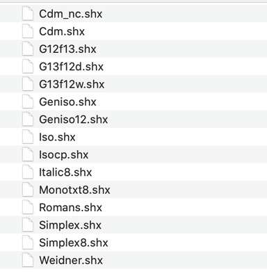

I am not able to see Arial.shx Shape font file in Fusion installed folder. Below is the list of shape font files present there. I tried your script with 'Weidner.shx' and it worked for me. May be you can try once on your side as well. Thanks.
