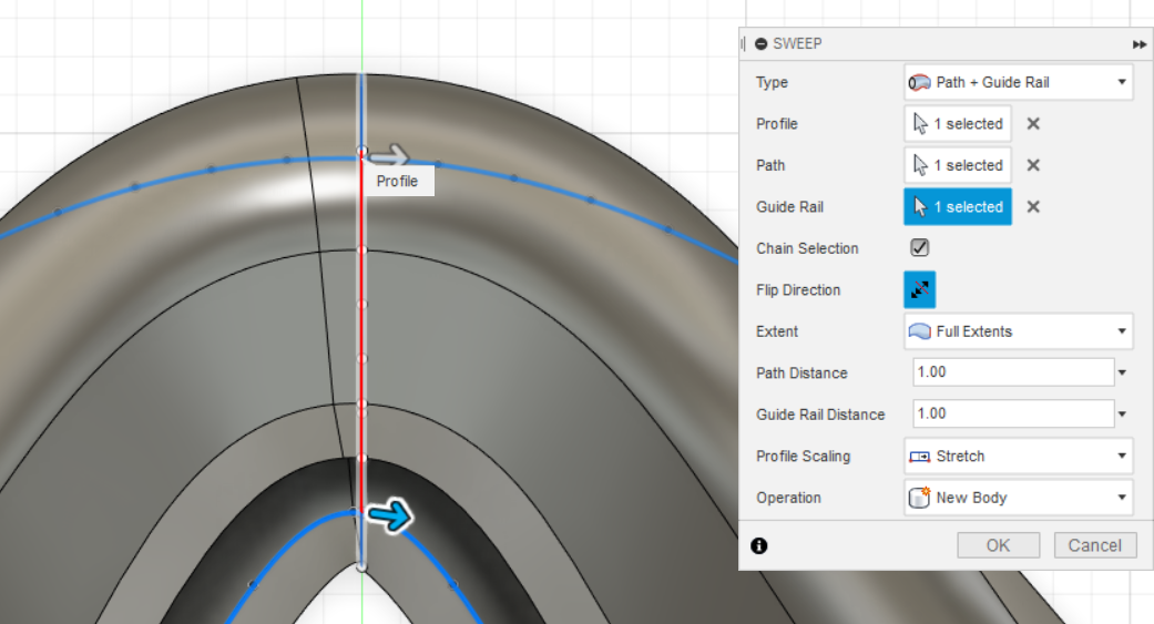

I've looked through the api reference manual and cannot find the 'Extent' parameter on the sweep with guide rails feature. With the extent feature set to 'Perpendicular to Path' (default) a gap is left in the top of my sweep.
See 'Forum Image'
With extent set to 'Full Extents' it fills the gap, solving my problem. See 'Forum Image 2'.
I am wondering if I am missing it somewhere in the api documentation or if there is a chance it hasn't been implemented yet?
