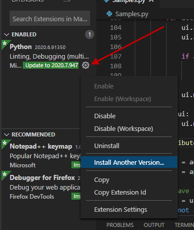

BrianEkins
I'm having the same problem.  I downgraded the Python extension to the previous version and that seemed to fix it.  Seems to be an issue with the new extension so there's either a problem with it or something changed that affects how Fusion talks to it.
Brian Ekins
Website/Blog: https://EkinsSolutions.com
Brian,
Thank You.  Worked.
