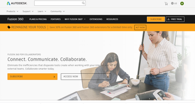

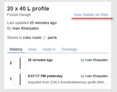

LiveLover
Hello @sasikanth.kollipara! Thank you for replying!
https://www.autodesk.com/products/fusion-360/collaborator
shows me
is this because I have no some (what?) subscription?
And "ViewDetails on Web" brings me to a web observer for my projects
sasikanth.kollipara
You can click Access now on the above screenshot you shared and you should be able to view the web interface.
And if you have the proper entitlement in Fusion, you are free to use this web interface for all your data management activities.  You can do File operations pretty easy along with the review capabilities.
