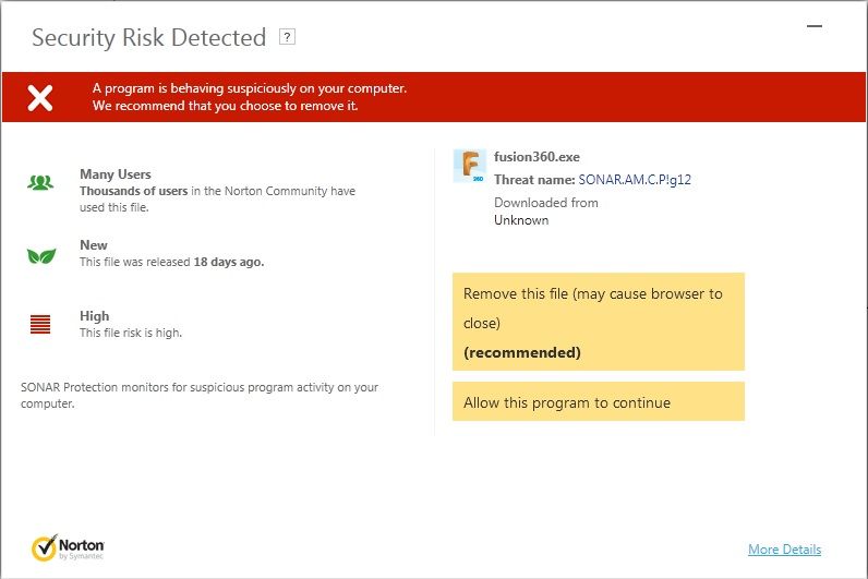

The situation here is that Symantec's anti-virus tool is using heuristics to spot malware type behavior in applications. A couple of actions taken by Fusion 360 can trigger these heuristics, though we don't have enough information to know exactly which combination or timing of actions is the problem. (This is intentional, if Norton shared this information then virus writers would know how to avoid it). Our suspicion is that Fusion's automatic update mechanism, installation in a per-user location and use of multiple executable files are the behaviors which cause it to be flagged.
We have worked with Symantec in the past to get Fusion whitelisted, however the nature of the checks being made mean that their whitelisting can break any time we release an update. (Technical explanation, they use checksums on the executable file as part of the whitelisting criteria, and these change every time we update Fusion).
If individual users report false positives to Symantec then it prompts them to update their whitelist definitions, if a significant number of users report false positives then it may trigger a more lasting change in the heuristics which would prevent future occurrences. I will be reaching out to Symantec to explore options, but would definitely appreciate false positive reports from Symantec customers as supporting data that a change is needed.

Just adding my experience with this as well.  Also, my update this morning just hangs at 98% complete and never finishes.  Is this part of the same problem?  Here is what's copied to my clipboard:
Filename: fusion360.exe
Threat name: SONAR.AM.C.P!g12Full Path: c:\users\juan\appdata\local\autodesk\webdeploy\production\5308b208c635b362e208fc86d5a97f2fcda381e2\fusion360.exe

fusion360.exe Threat name: SONAR.AM.C.P!g12
Locate
Many Users
Thousands of users in the Norton Community have used this file.
New
This file was released 18 days ago.
High
This file risk is high.

matt.pooley
Hi Everyone,
To provide an update, I have spoken to the Symantec support team, they do not offer a proactive whitelisting system at the moment ( https://submit.symantec.com/whitelist/ ), so the best we can do is submit false positive reports, which if accepted will result in definition files being updated within ~72 hours of the submission. we will be able to do this with enough advance notice for our regularly planned updates so that we will avoid alarms, but any hotfixes we release with a rapid turnaround run the risk of happening faster than this process allows, resulting in new false reports.
To apply a broader exclusion on clients, the process documented at https://support.norton.com/sp/en/us/home/current/solutions/kb20100222230832EN_EndUserProfile_en_us can be used to exclude a specific folder, for example setting a SONAR exclusion on the folder %LOCALAPPDATA%\Autodesk\webdeploy\production will avoid future alarms, but will unfortunately expose you to issues if some other malware tries to use our installation area. I would not suggest setting this broad exclusion unless you are very confident in the security of your computer, regularly apply other security patches, and avoid public wi-fi connections.
Regards,
Matt Pooley
On Behalf of the Fusion Dev Team
