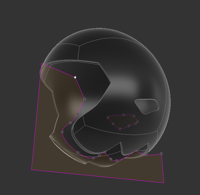

So I got well into creating a football helmet shell by starting with a quadball. I need to hollow the body so that the shell has a 3mm thickness, but the function isn't working as I expected. You'll be able to see in the attachment that I partially achieved it, but can't figure out what I need to do to get the whole body to hollow to the 3mm thickness I'm looking for.
Can anyone give me any guidance on this one? Did I miss a step somewhere?

Hi Christopher,
The principle could be like this:
how to hollow somethinghow to hollow something
Then all you have to do is get your head in it.

Is this closer to what you want? See attached File. Also do yourself a favour and do some of the hands on exercises in the help. Extrude does the job a lot better than split body.

Shell straight after the Quad ball, and before cutting any shapes or holes,
Might help....

In this case if you use extrude cut you're not left with the extra bodies. I'm assuming the 2 extra bodies in your version using split were not needed.

Did you try that? If you ever get into making bigger designs you want an efficient timeline so removing what you don't want with one extrude is better than 2 splits then 2 removes.
