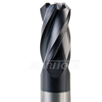

Right now on an endmill you can specifiy a coner radius, I want to be able to specifiy a corner chamfer for tools like this:

No, that doesn't work. That won't cut to full depth, it will step out to keep a 45 deg angle to the toolpaths. That's what I had started with...
al.whatmough
I beleive your issue is that when you use a chamfer tool the contouring opperation defaults to enabling the chamfer fuction.
Simply uncheck the "chamfer" checkbox and you hsould be good to go.
Tbaker25
That's cool, but I'm not doing a 2D contour, I'm doing a 3D adaptive clearing.
