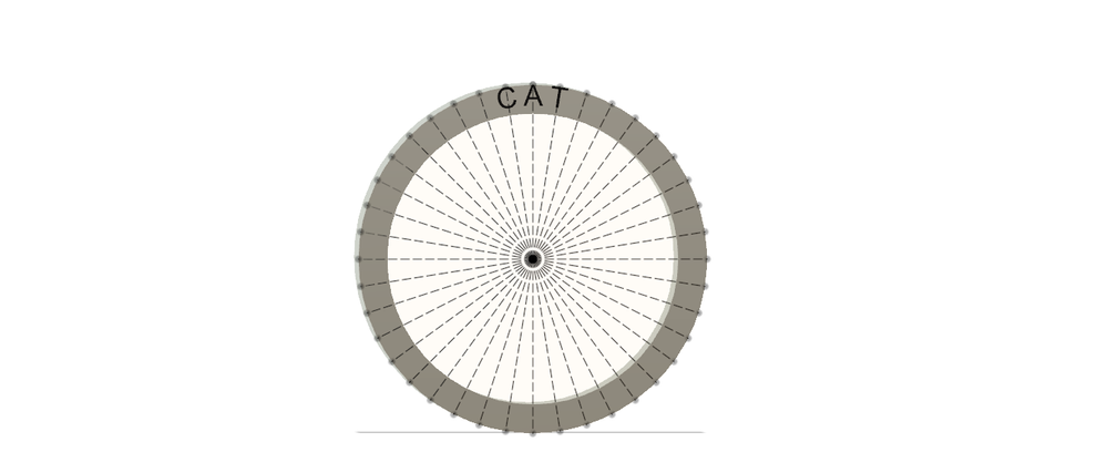

Thanks nicholis.j.hill, but I am not sure how that would give me 2D text like below (borrowed the image off the page you linked to). And if it does and I am not seeing it, great but that method is extremely clunky and not practical for me teaching beginning modelers in my junior drafting high school class.
Thanks for replying. I know its a bit rough around the edges as a method to create 3D curved text. I can understand you want to show your students the most in tune with the program features method as possible.
Hey I came up with this solution in real-time after reading these idea submissions about curved text. It's new to me too and I wouldn't really want to try teaching that method to students either because it seems quite primitive and limited.
I'll see what I can come up with for styling text in the manner you shared in that image.
It's sort of unfortunate a person cannot just change the angle of the profile of the text. It seems the only way to modify the text is to extrude the profile of the letters individually and then rotate them independently as a way to customize the orientation of the text style as in the example of the style shown in the image you provided. I'm going to work on this for awhile and see what gives.
Well this is basically the only system I could figure out to make text in the style you have in your image here:
The lines are separated at every 9 degrees which makes a total of 40 dividing lines. Then I created a letter that matched the dimensions of this setup and and extruded it. Next, I selected the letter 'C' from within the browser and chose the 'move' command and selected 'Free Move' and rotated the letter to the same degrees as the line I was planning on connecting it to which was 9 degrees. Then I selected the 'point to point' move feature and rotated to the back of the letter and chose a point location that was centered on the letter and then for the target point I chose the outermost point of a dividing line just one position left of the top center line and the letter moved precisely to the location to merge those two points. The letter 'A' required no rotation of the angle of course and all I had to do with that was match two points with the 'point to point' move feature.The lines are separated at every 9 degrees which makes a total of 40 dividing lines. Then I created a letter that matched the dimensions of this setup and and extruded it. Next, I selected the letter 'C' from within the browser and chose the 'move' command and selected 'Free Move' and rotated the letter to the same degrees as the line I was planning on connecting it to which was 9 degrees. Then I selected the 'point to point' move feature and rotated to the back of the letter and chose a point location that was centered on the letter and then for the target point I chose the outermost point of a dividing line just one position left of the top center line and the letter moved precisely to the location to merge those two points. The letter 'A' required no rotation of the angle of course and all I had to do with that was match two points with the 'point to point' move feature.
Well now I really understand why people are voting and submitting the idea to make it so Fusion 360 has a Text modifying feature that aligns the angles to the manner a user is wanting the text to align because it really is a bit of a repetitive complicated process to get text to align in this particular way. However, I think by creating a circle as I did and adding evenly spaced and divided lines in a sketch it makes the whole process much more systematic and forgiving compared to just eyeballing things and manually moving text letters around at random. Interesting. I have learned new things here and I'm glad for that.
